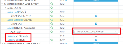

I have issue on Key Establish and Wrap/Unwrap example.
I have X-NUCLEO-SAFEA1 and NUCLEO-L476RG for testing.
I downloaded X-CUBE-SAFEA1 from ST web site, version is V1.2.2.
Here's what I tried.
Could you help me to understand what's going on?

I have a very similar issue to original post where the Key Establishment and Wrap/Unwrap envelope demos do not succeed.
Key Establishment demo fails on step 3 when calling mbedtls_ecp_mul. It is passing a NULL value for rng function to mbedtls_ecp_mul_restartable which then returns MBEDTLS_ERR_ECP_BAD_INPUT_DATA.
Wrap/Unwrap demonstration fails on step 2 StSafeA_WrapLocalEnvelope where the local envelope response is STSAFEA_KEY_NOT_FOUND

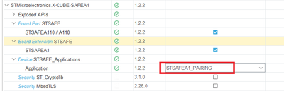

Here are a few things that were interfering with my "all_use_cases" not running properly:
