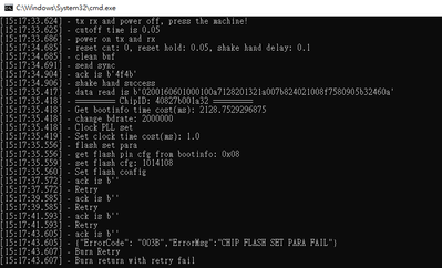

Hi @EPASZ.1,
Thank you for the explanation. The method you described seems to apply to the scenario where the ST67 firmware is updated via the STM32 host using the STM32CubeMX generated code.
However, my current goal is to flash the chip directly via PC (using an FTDI cable). I am following section "5.2 Flashing the ST67W611M1 using QConn_Flash without an STM32 host (standalone mode)".
Could you provide some insights on why the standalone mode is failing? Are there any other specific hardware requirements (e.g., UART Baud rate limits, power supply transients) for this standalone sequence?
Any insights would be greatly appreciated!
