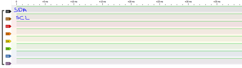

On my I2C logic analyser we can see that both of my signals are HIGH......
Does anyone have a idea of my problem ?
