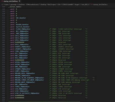

2026-05-06 12:17 AM - edited 2026-05-06 1:58 AM
Hello @ncdanie
Using the latest version of STM32CubeMX6.17.0
.word MRSUBG_BUSY_IRQHandler /* IRQ20: MR SUBG BUSY interrupt */
.word MRSUBG_IRQHandler /* IRQ21: MR SUBG interrupt */
.word MRSUBG_TX_RX_SEQUENCE_IRQHandler /* IRQ22: MR SUBG TX RX Sequence interrupt */
.word MRSUBG_TIMER_CPU_WKUP_IRQHandler /* IRQ23: MR SUBG TIMER CPU Wakeup interrupt */
.word MRSUBG_WKUP_IRQHandler /* IRQ24: MR SUBG Wakeup interrupt */
