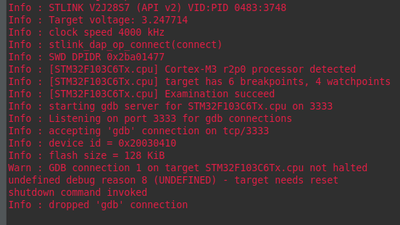

This is , what happens on IDE debug : STM32F103C6 project , but i connect to st-linkV2 an AIR32F103 :
is correct connected, but refuse to work.
Info : device id = 0x20030410
Info : flash size = 128 KiB

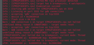

But with a real STM32F103C8 now :
debug...main.c .
Info : device id = 0x20036410
Info : flash size = 64 KiB
So check: your device ID is totally different: Info : device id = 0x10010414
Whats written on the chips ?
