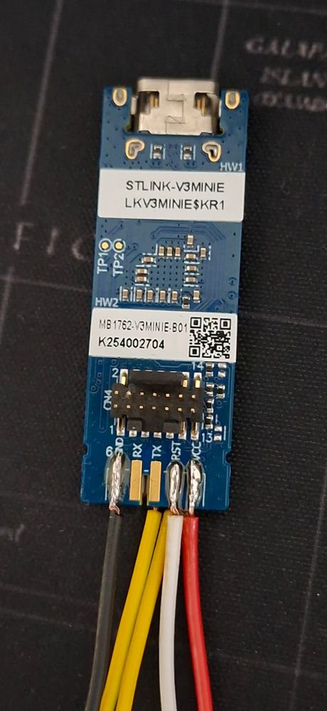

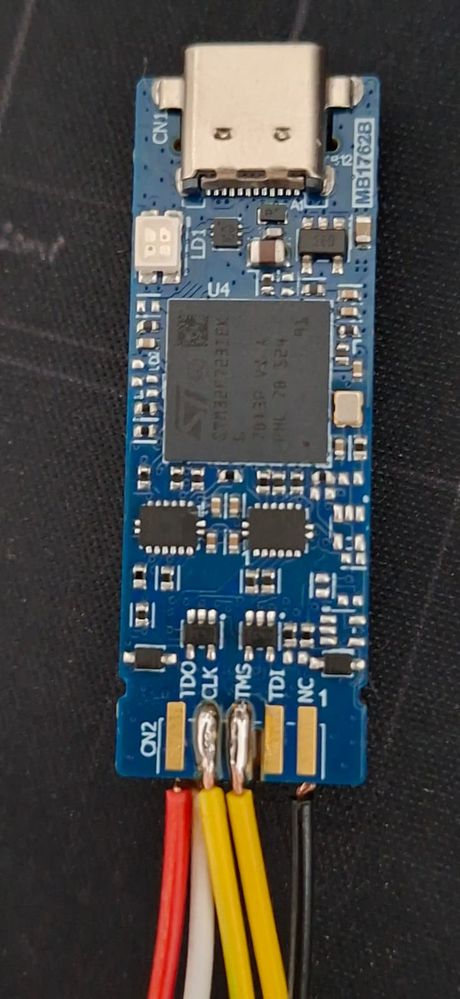

STLink: STLINK-V3MINIE

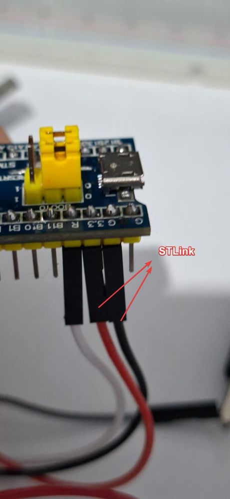

Card: STM32f103C8T6

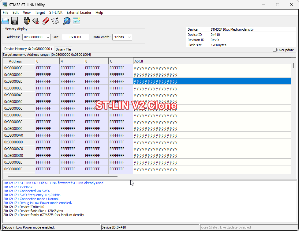

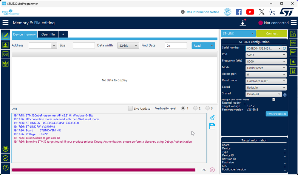

I couldn't establish the connection at all. I can connect without any problems with the ST-LinkV2 clone, but I couldn't connect with the V3. I'm trying different tim variations, but it's not working.
The frequencies have been changed.
The modes have been changed.
The reset modes have been changed.

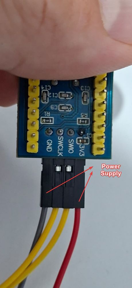

Looks hooked up correctly to me, except SWDIO/SWCLK may be swapped since they have the same color.
Consider getting a genuine board like NUCLEO-F103RB.

I've tried swapping them around maybe 10 times. Don't think of it as a card; I'll remove this MCU from this card and mount it on my own card, and I'll do the debugging and compilation work there, but I haven't gotten past the connection stage yet :) :).

@DevLoper wrote:I think the MCU is original.
What makes you think that? On a "Blue Pill" board like you have, it's unlikely,
This might identify what you have:
https://mecrisp-stellaris-folkdoc.sourceforge.io/bluepill-diagnostics-v1.6.html#diags-1-6
@DevLoper wrote:What really bothers me is that the clones work perfectly fine for me, but the original product can't do anything :)
Because the clone ST-Links don't care if you have a clone STM32
PS:
See also: https://hackaday.com/2021/06/23/test-your-blue-pill-board-for-a-genuine-stm32f103c8-mcu/
And: https://hackaday.com/2020/10/22/stm32-clones-the-good-the-bad-and-the-ugly/
And: https://github.com/keirf/Greaseweazle/wiki/STM32-Fakes#rogues-gallery

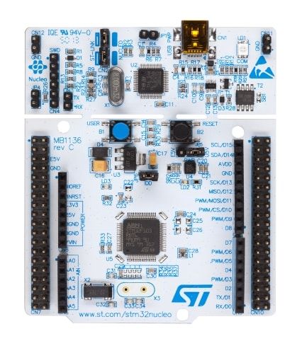

@DevLoper wrote:Can I program STM32 processors, whether original or clone, using a product like the NUCLEO-F103RB, ?
You can certainly use the ST-Link part of a Nucleo board to program genuine STM32 parts - that is well-documented in the product manual.
But the same thing applies to using it with non-ST parts.
