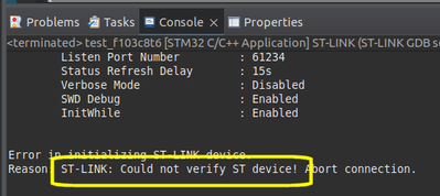

I was working on STM32F103C8T6 Bluepill board. I was using this board with ST-LinkV2 to connect with CubeIDE. When i tried to flash a sample LED blink program via CubeIDE, it gave an error saying 'Target not found'. But at the same time i was able to connect this board via cube programmer using same ST-Link and write sample LED code into the board.

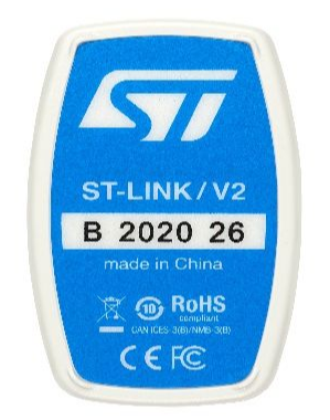

How to recognize a genuine ST-LINK/V2 versus a cloned one. TL;DR: if it looks like a USB memory stick, it's a clone.
@kiranraj_k_r wrote:When i tried to flash a sample LED blink program via CubeIDE, it gave an error saying 'Target not found'.
Please show the full error message, and log.
It is common that CubeIDE will refuse to work with clone chips & ST-Links; CubeProgrammer may be more forgiving.

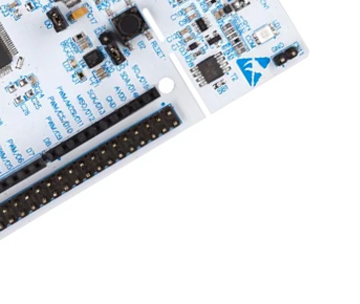

ST's NUCLEO-F103RB gives you:
I would certainly recommend this as a better option for a beginner and, by the time you've bought a Blue Pill plus separate ST-Link, it may not even be any (or much) more expensive!

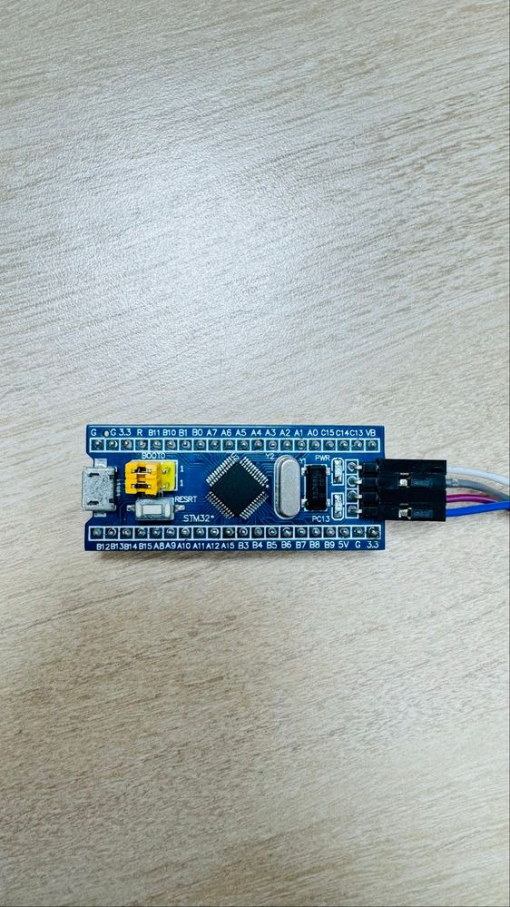

2. IDE checking for "fake" target, thats almost just other manufacturer of F103-similar chip, CubeProgrammer more "forgiving" , also works with F103-similar chip.
3. show good pic of F103 on bluepill board, if possible .

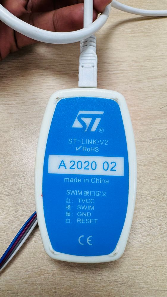

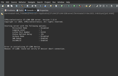

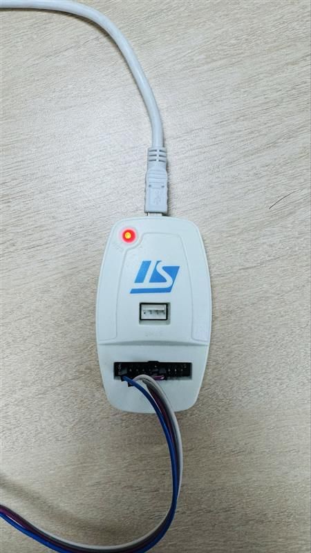

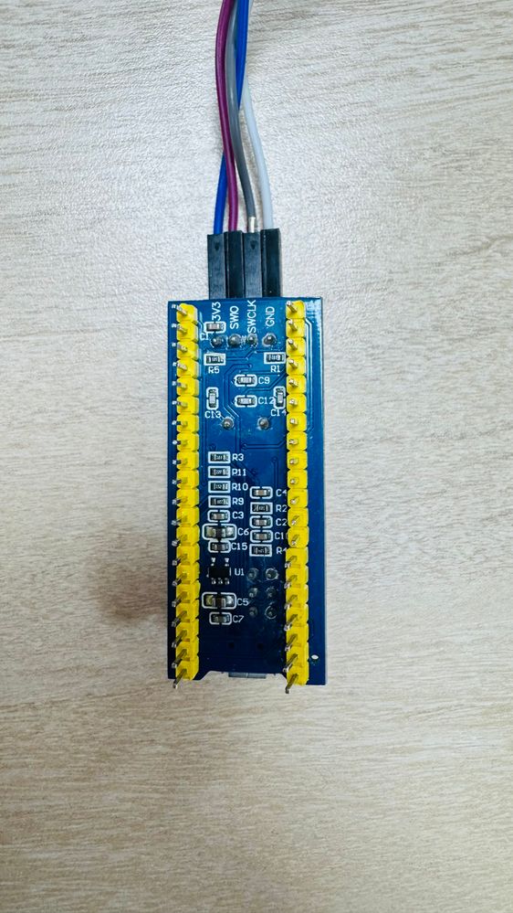

I am using genuine ST-Link(photo attached).
Error message from CubeIDE and photo of Bluepill board attached.
I am using CubeIDE Version: 2.0.0 and CubeMX Version 6.16.1 on Linux 22.04.

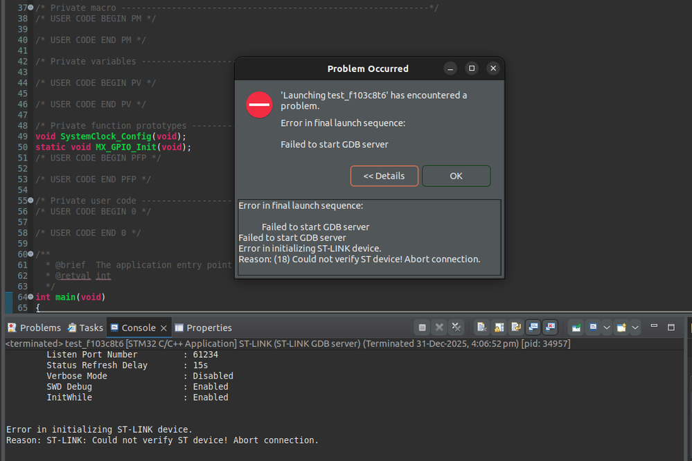

product I am using : https://robu.in/product/stm32f103c8t6-minimum-system-board-microcomputer-stm32-arm-core-board/issue facing while trying to debug - GDB issue
I am also facing a GBD error while trying to debug

@kiranraj_k_r wrote:I am using genuine ST-Link(photo attached).
Your photo does not match the How to recognize a genuine ST-LINK/V2 versus a cloned one article:

I think that is to be expected with a fake STM32 and/or clone ST-Link.
Again, I would strongly recommend that you at least start with a genuine ST board, so that you can gain familiarity with the product & tools using known-good hardware - without having to worry about all the extra unknowns with fakes/clones.
The forum is littered with people struggling due to the issues of fakes/clones - save yourself the grief!

Also, "3. show good pic of F103 on bluepill board" means a good closeup of the MCU chip so that we can see exactly what's written on it.
This diagnostic may also help to see what MCU is actually on your board:
https://mecrisp-stellaris-folkdoc.sourceforge.io/bluepill-diagnostics-v1.6.html#diags-1-6
2025-12-31 3:14 AM
Why do I feel your ST-Link connections are wrong?!
Could you please verify that once.

@Andrew Neil wrote:
@kiranraj_k_r wrote:I am using genuine ST-Link (photo attached).
@kiranraj_k_r Confirmed here (by @mƎALLEm) that it's not genuine.

And your Chinese st-link probably also, thats why IDE telling: could not verfy ST device.

- for better behaviour, debug in IDE etc. , buy a cheap nucleo board (genuine from STM) , like this:
https://robu.in/product/nucleo-f303re/
+ here also the st-link attached, can separate even.
