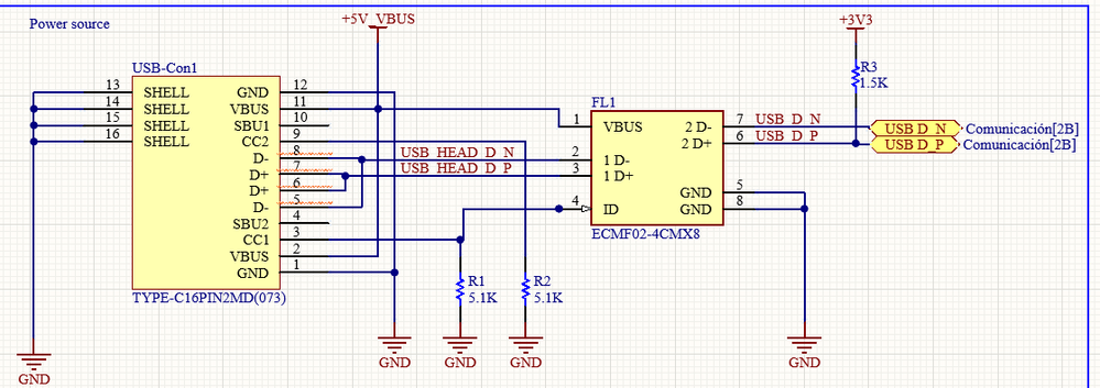

Here are the schematics for that part of the board:

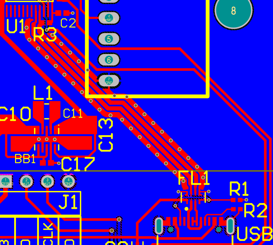

And the layout:

Check the wiring of USB-C connector. The common ones have alternating D+ D- D+ D- pins. On your PCB the wiring is D+ D+ D- D- - looks strange to me.

2026-02-22 3:26 PM
Yep, you were right.... thank you so much, Now I have to think how to solve it.
My layout was D- D+ D+ D- and rechecking the datasheet it should be D- D+ D- D+.
Thank you so much for noticing this, it's been too long on this.
