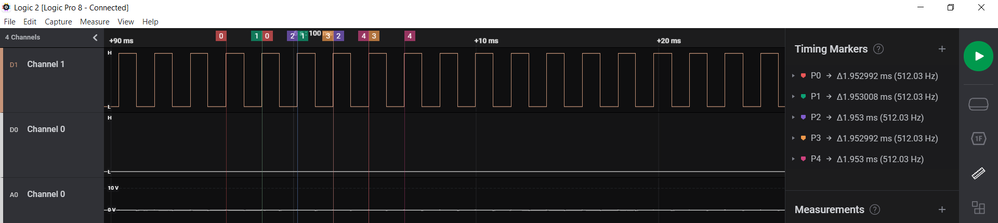

question 2: I have enabled calibration out for RTC 512Hz, and if I probe that to logic analyzer
I am seeing 512.035
512.033
512.031
512.035
512.033
Average = 512.0334
(512/512.0334) - 1 *1000000 ==> -65.23ppm (but is this correct) since i referred from APP notes
