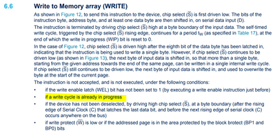

Your write signals look fine. Show the corresponding read function immediately following a write and/or corresponding code.
Note that a write will fail if one is already in progress. Given your every-other failure scheme, I bet this is what is occurring. I don't see any checking for the WIP bit.
