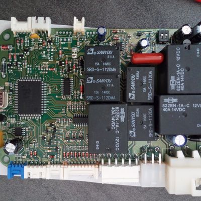

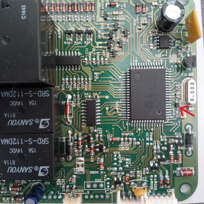

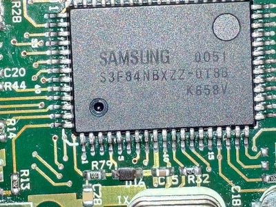

i'm confused about this part with the (UM smd code),
i searched a lot on google and but i found only 2 parts with this smd code... (zener diode and tvs diode) !!:thinking_face:
my first find --> zener diode Bzx84j-C5V6 SOD-323
and next my find -->(TVS Diode) with part number (SMAJ15CA)
i got crazy:face_with_rolling_eyes:.. which one should i choose????
.i really need your help:eyes:
T H A N K YOU So sO So MUCH:folded_hands::smiling_face_with_heart_eyes:

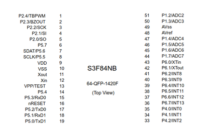

the cpu seems 5V type, s3f84nb , qfp64:
So pin4 (the diode goes here and to pin 9 , VDD) is a protected input : guessing -> a 5V6 zener makes more sense here, than a 15V protector.

What board is it ?
and which cpu ?
Why you ask ? (It looks good...not working - or ??)
2024-04-27 4:18 AM
Hello:hand_with_fingers_splayed:
thank U for asking?
1.its a mainboard of security car alarm system.
2-SAMSUNG --> S3F84NBXZZ-QT8B
3.shorted :frowning_face:
4.please tell me which one should i choose??
5.thank U again

2024-04-27 6:28 AM
first of all, thank U for your time:folded_hands::smiling_face_with_smiling_eyes:
then i have to say this ; i tested this diode with a multimeter both inside the circuit and outside the circuit, and in both cases the multimete showed zero volts. idk why:flushed_face:?
i hope it will be fixed:slightly_frowning_face:
anyway thank you SO MUCH for your guidance
