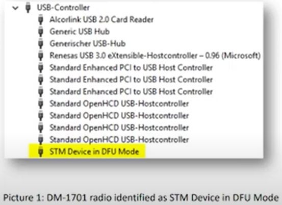

According to the manual and all YouTube videos I can find on it, once the cable and radio are attached to the USB port, Device Manager should show under USB: STM Device in DFU mode:

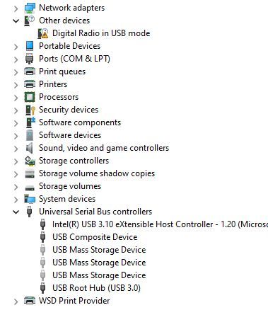

However, this is what Device Manager shows me:
So it shows the connection to the radio under Other Devices, but it will not show it as a USB connection, and without that, the programming software will not connect. Asking around on some HAM radio forums, I was told that it is a problem with the ST driver. But then again, I was also told there is no driver needed, Win recognizes it.

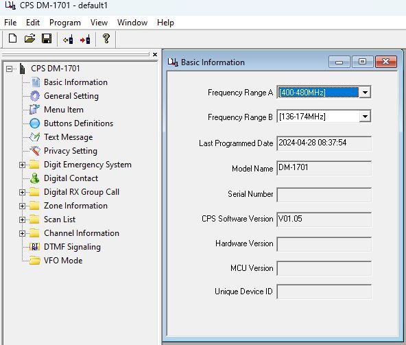

Hi Peter,
I finally got it to work.
I tried to update the driver, and it finally gave me an error that my Memory was locked, and I should go into my security settings and unlock it.
I did, et voila, it is now working!
Thank you!
