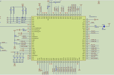

After commencing debugging with the JLink, these faults persistently occur after approximately 30 seconds. However, this JLink functions correctly when debugging IAR. What might be the cause?
The actual chip used is the STM32F407VET6.
JLink keeps disconnecting from CubeIDE for some reason. Debugging frequency SWD=500k

Welcome @cgc, to the community!
If, as shown in your schematics, the GD32F407VET6 is used, you should ask its manufacturer Gigadevice.

The schematic diagram is as follows:

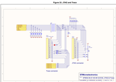

Hello @cgc and welcome to the ST community,
You can start by checking your JTAG hardware part by inspiring from one of ST Eval boards (Example: STM3240G-EVAL:(
Regards
/Peter
Nice catch.. I didn't see it ;)
