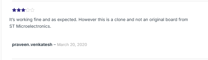

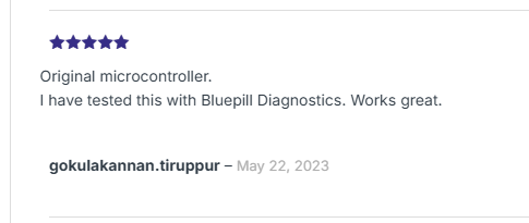

@AScha.3 wrote:from the links -> board comment:
> This is a clone, so it wont work with debug mode in stm32CubeIDE. Otherwise working fine
> priyammascharak2002 – January 5, 2024
Also:
But then:
Which is the trouble with these no-name boards - it's a matter of luck what you actually get!
See also the pinout discrepancies with the clone ST-Links.
@Bharath_5 hence the suggestion to use a genuine Nucleo board - so you know what you're getting!
