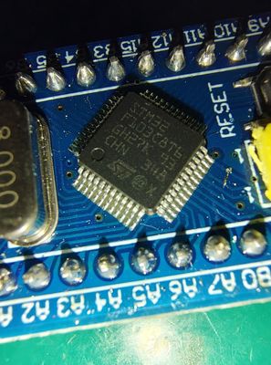

2025-10-27 11:21 PM
Hello @AScha.3,
Thank you for your response. I really appreciate your time and support.
Close-up photo of the STM32F103C9T6 Micro-controller you said for and below is the purchase link from where I have purchased the Blue pill and ST-Link V2.

2025-10-28 4:33 AM
from the links -> board comment:
> This is a clone, so it wont work with debug mode in stm32CubeIDE. Otherwise working fine
> priyammascharak2002 – January 5, 2024
So we can assume: big chance, to have a cpu not by STM on the board.
But anyway , we should get a connection in CubeProgrammer, even if it might show "wrong" chip ID .
(Only debug mode in IDE then not possible.)
You have a scope ? Then check, what happens on pill board at SWD + SWC lines, when click >connect< in CubeProgrammer.
