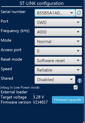

My firmware version is V2J46S7.
I have downloaded the latest version of both CubeProgrammer (V2.20.0) and STMCubeIDE (V1.19.0).
I have updated my Firmware again, but I am facing the same issue

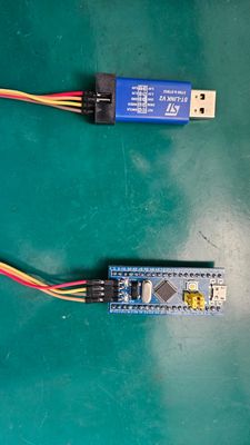

I am using the below STM32F103C8T6(Blue Pill) and ST-Link V2.
2025-10-26 10:54 PM
Hello @Issamos,
Thank you for your response. I really appreciate your time and support.
Is the Blue Pill and ST-Link I am using not original?
2025-10-26 11:42 PM
Every BluePIll is perfectly original. The problem is not so many BluePills contain STM32 microcontrollers. Most of them use Chinese clones.
Your debug module is a Chinese clone of ST-Link, which violates ST licences.
During last 4 years ST put some effort toward not supporting the illegal ST-Link clones and non-ST microcontrollers in their software and they have full rights to do this.
Technically it's still possible to use the hardware you have for development but since it's ST-owned forum, describing how to compromise their intellectual rights protection does not seem to be proper.
There is usually nothing wrong with BluePills, it's just you are not entitled to use ST software and illegally cloned debug hardware for development.
For non-commercial stuff you may use any non-STM32 BluePill with Keil MDK-ARM and CMSIS-DAP debug interface.
