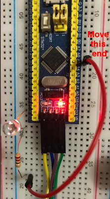

The wire connections (like screenshot below):
PA5 pin => Resistor => Long leg (anode) of LED
Short leg (cathode) => GND on Blue Pill
And finally code:

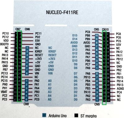

@TechyAry wrote:2- Is there any specific type of breadboard I can purchase for my Nucleo board? (So that I can access all pins on the edges as well as the ones on the green lines below)
Probably not - because you need separate connections to pairs of adjacent pins.
But they are standard 0.1" pitch - so can be used with standard soldered prototyping boards.
You can also get prototyping boards to fit on the Arduino connectors.
But this a separate question - please start a new thread in the STM32 MCUs Boards and hardware tools section for that.

What's going on here:
You seem to have both the LED and the resistor pushed into the same hole on the breadboard?!
2025-08-09 1:56 AM - edited 2025-08-09 1:57 AM
> What testing/debugging/investigation have you done to find what's wrong?
Using 3.3 => Anode => Cathode => resister => GND the LED turns on
Also, when using PC13 for the same purpose, the onboard LED blinks correctly.
Not sure what else I should do.
> If you simply take that flying lead and connect it to +3V, does the LED light?
You mean anode to 3.3 and cathode to GND without a resister?
yeah, because the resister's leads are very thin and I doubted they might not fit well into the holes.

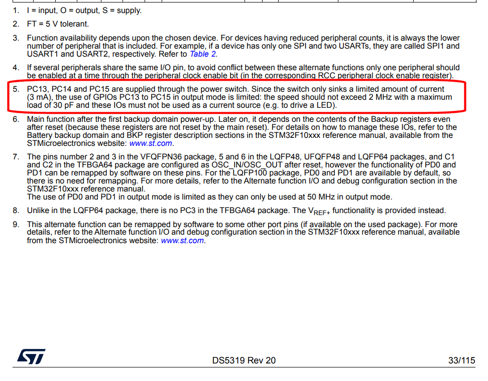

Note that, for a real STM32, it's not recommended to drive LEDs from PC13, PC14 or PC15:
https://www.st.com/resource/en/datasheet/stm32f103c8.pdf#page=33

I meant to just take the top end of the red wire, and connect it to +3V:
@TechyAry wrote:yeah, because the resister's leads are very thin and I doubted they might not fit well into the holes.
and yet you have the other end in a hole on its own?!
Seriously, putting 2 wires into 1 hole is more likely to give an unreliable connection.
2025-08-09 4:16 AM - edited 2025-08-09 4:17 AM
Connecting the top end of the red wire to +3V will turn on the LED.
I also tested PB8 instead of PA5, yet no success.
The mcu seems to be normally connecting to the bread board.

1- Is the issue then with the blue pill itself? (Or maybe its debugger or utility)

@TechyAry wrote:The mcu seems to be normally connecting to the bread board.
it looks like you have double-ended headers on your board; ie, connections are accessible both above & below the pill board.
So have you tried connecting direct to the "top" end of the header - instead of via the breadboard?
Breadboard contacts are notoriously unreliable.

Ended up being using male-to-female jumper wires. Handy.
