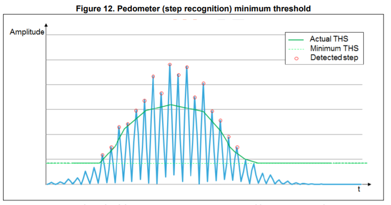

if you are searching for a combination of low current consumption (an accelerometer instead of an IMU) and for embedded step counter, you might consider the LIS2DS12 accelerometer, which current consumption is similar to the LIS3DH one (12 uA at ODR=100Hz LP versus 11uA at ODR = 50Hz NM).
As you can see from the datasheet, p.31, the pedometer generates an interrupt when a step is recognized, the step counter (automatically enabled when step detector is on) counts the number of the steps detected. Step Detector/Step Counter (SD/SC) are enabled by setting to ‘1’-logic the STEP_CNT_ON bit in the FUNC_CTRL (3Fh) register. Additional pedometer advanced configurations can be used if the FUNC_CFG_EN bit in CTRL2 (21h) is set to "1".
Further details about the parameters to be configured and the correspondent registers are available from page 62.
Moreover, a simple configuration for this embedded feature can be found in the application note AN4748, p.29:

Hi Brian @brian239955_stm1 ,

2025-02-26 1:50 PM
Hello there,
I'm looking for some more information on how the Pedometer works. Does the device need to be attached to the ankle in order to detect steps? I was looking in the configuration registers on the datasheet that was linked above, but I'm curious about the versatility of this. I've got a client interested in adding step counts to their product and I'd like to find a bit more information about whether or not this could be a turn key solution for that feature.
