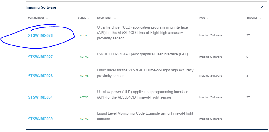

Yes, I can try the normal driver. I think you mean the IMG026, right?
In case we want to detect this situation where sunligth is higher than normal we could use the
ambLigthvalue extracted from the ranging result, right?
I will get back when tested.
Regards, Ramon.
2022-11-29 8:47 AM
Exactly correct. As you dig into it you will notice that the ULP adn the ULD are really similar. The ULP is just tuned to integrate for a really short period of time. So short, you really don't get much accuracy.
