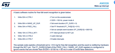

I'm using an STM32U575 with an I2C connection to the AIS2DW12 accelerometer. The goal is to generate an interrupt when a free-fall event is detected. I followed the instructions provided in the datasheet (AN5326 - AIS2DW12 ultralow-power 3-axis accelerometer for automotive applications, STMicroelectronics).
I created a function to initialize the device using the specified register values, but no interrupt is detected. There are no hardware issues—when I force the INT1 pin to a high level, the MCU correctly enters the interrupt function. Later, I found a GitHub example for free-fall detection that doesn’t use interrupts. I still imported that code block into my project as an additional initialization function :

/* Configure Free Fall duration and samples count */
ais2dw12_ff_dur_set(&Ais2dw_ctx, 0x06);
ais2dw12_ff_threshold_set(&Ais2dw_ctx, AIS2DW12_FF_TSH_10LSb_FS2g);
/* Enable free fall interrupt */
ais2dw12_pin_int1_route_get(&Ais2dw_ctx, &int_route.ctrl4_int1);
int_route.ctrl4_int1.int1_ff = PROPERTY_ENABLE;
ais2dw12_pin_int1_route_set(&Ais2dw_ctx, &int_route.ctrl4_int1);
/* Set latched interrupt */
ais2dw12_int_notification_set(&Ais2dw_ctx, AIS2DW12_INT_LATCHED);
