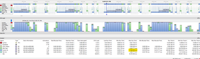

I am using MotionFX Library on stm32wl55 (CM4 without FPU). run at 48MHz (max frequency)
it is impossible to run MotionFX_CM4F_wc32_ot.a
so i use :MotionFX_CM3_wc32_ot.a and it is work.
by debugging, the MotionFX_manager_run function take different execution time in different cycles?. in general, it tack 1 or 2 ms for 3 or 4 cycles, than 10 to 15 ms for the 5th cycle ! (trying Oz and Ofast optimisation)
it is normal ?
in attachment a screenshot for fusion execution real time record.

When MotionFX_manager_run takes more time, it is due to the MotionFX_update call.
It is possible to reduce the number of calls by increasing DECIMATION.
To process all data correctly and obtain the correct output from the sensor fusion algorithm, I read the data from the IMU when an interrupt occurs (INT1 is set when data is available), i save the data in a FreeRTOS queue, then it is processed later by a specific task
