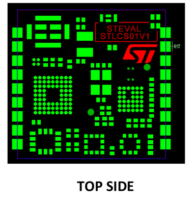

Look at the circuit...
https://www.st.com/resource/en/schematic_pack/steval-stlcs01v1_schematic.pdf
also Gerber files ...

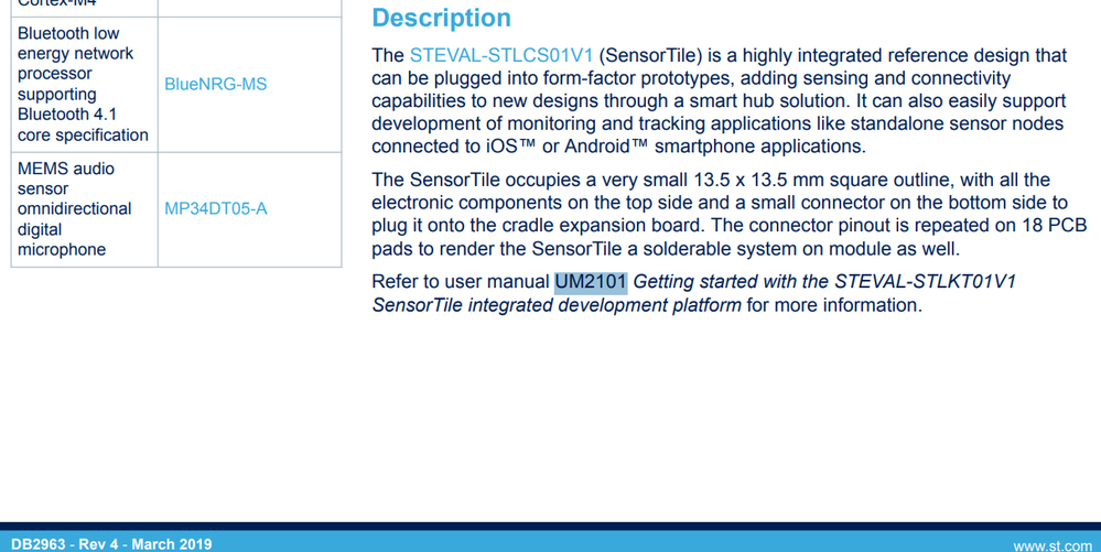

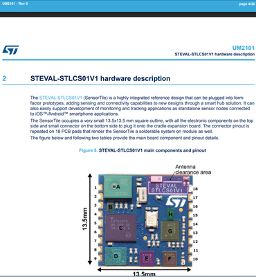

OK, so the Data Brief does mention UM2101:
but not as a clickable link, and it is not mentioned on the Product Page

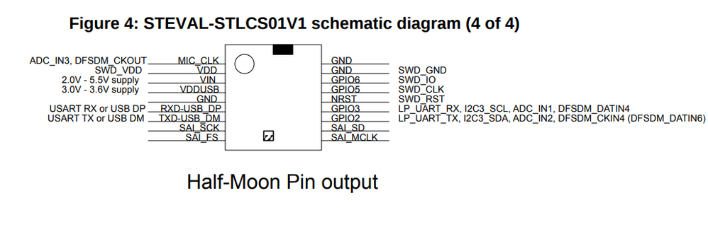

UM2101 does give the pinout:
but still not the pitch of the connections.
That also gives only pinout - not pitch.
PS:
You added mention of the Gerbers.
Yes, I'm sure it is in there - but, surely, this should be documented in the User Manual, or other human-readable document(s) ?
Chip datasheets give dimensioned package drawings ...
see the gerber files... :)
Again, this should be documented in the User Manual, or other human-readable document(s).
After all, chip datasheets give dimensioned package drawings ..
