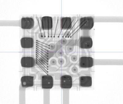

Below i have upload a X-ray sample of effected chip.

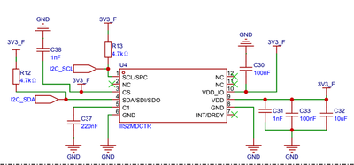

I measure the consumption of my entire board that must be around 30 µA.
With the schematics below, I measure ~450 µA.
The current consumption is unstable and is sensitive to magnetic field variations, which is why I initially suspected the floating INT/DRDY pin.
As I sais, with a pull down (20K) this consumption disappears.
Unfortunately, my IIS2MDC is integrated on a PCB and I will be unable to disconnect communication pins without being too destructive. But I will end up doing it, and share my updates here.

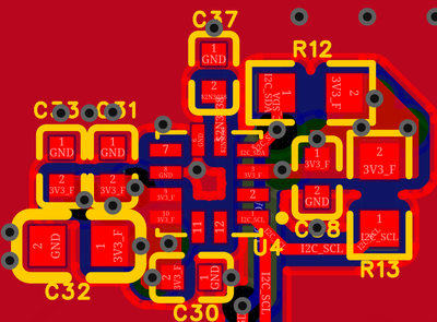

Indeed, my consumption may come from back powering thought I2C and its 2 pull up. However, this consumption didn't happen on my previous PCB generation. The magneto routing didn't change at all. Its package is the following : LGA-12_L2.0-W2.0-P0.50-TL
Here are my schematics :
