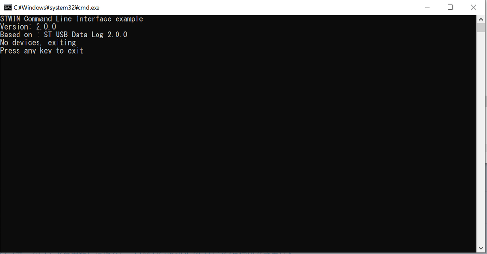

Connect STEVAL-STWINKT1 and PC. Execute USB_DataLog_Run.bat of 1.1 USB mode-command line example described in the user manual "UM2686". However, it says no device.

you should download the .bin binary file of the HSDatalog on the STWINKT1 board, in order to make it be recognized by the software. The default FW on the STWIN communicates via BLE; so it has to be changed for the USB communication.
In the HSDatalog application the USB is not recognized as serial port (VCOM): our internal experts are confirming me that they will change the documentation to better explain and simplify these steps.
