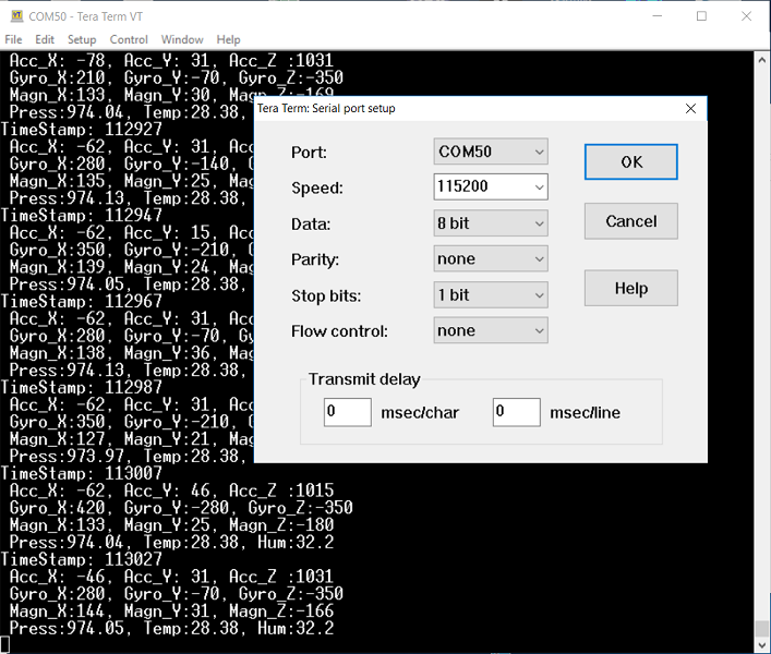

Hi @RMess.1 , sorry for the late feedback mostly due to vacation time... if I well understand your problem, you run USB_DataLog_Run.bat but it is not able to detect you, right? Did you configured the related VCOM port in the correct way (as shown in the below picture)?
