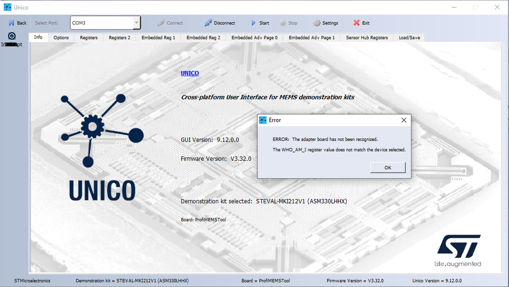

I get this error that says it does not know the chip id when I select the MKI212V1 as shown in the screenshot above.
All my software tools seem to be on the latest revisions. Anyway I updated the board with the last firmware using this video : Same issue.

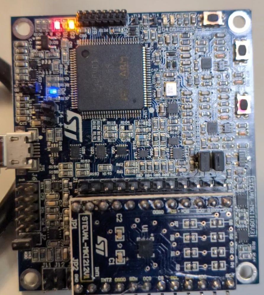

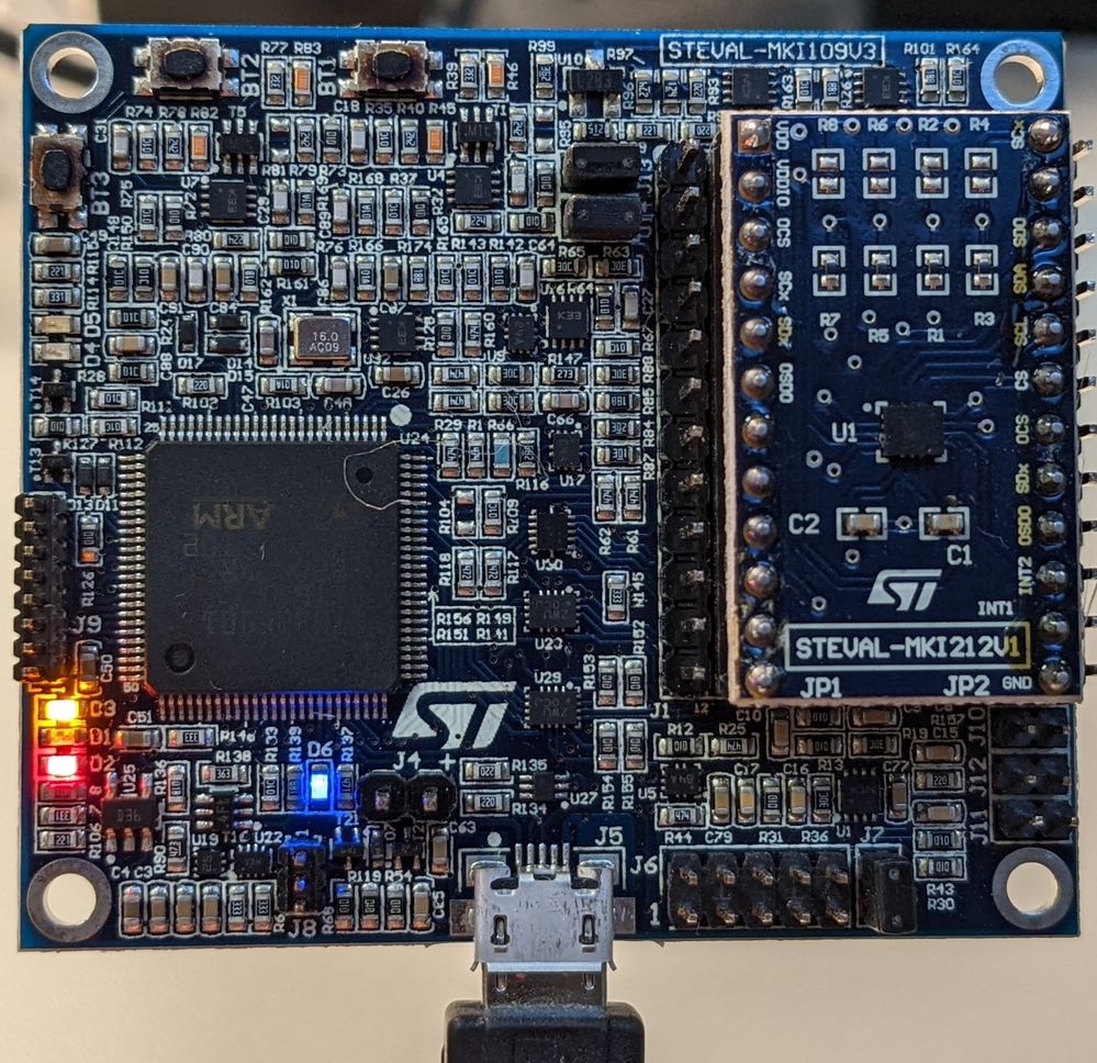

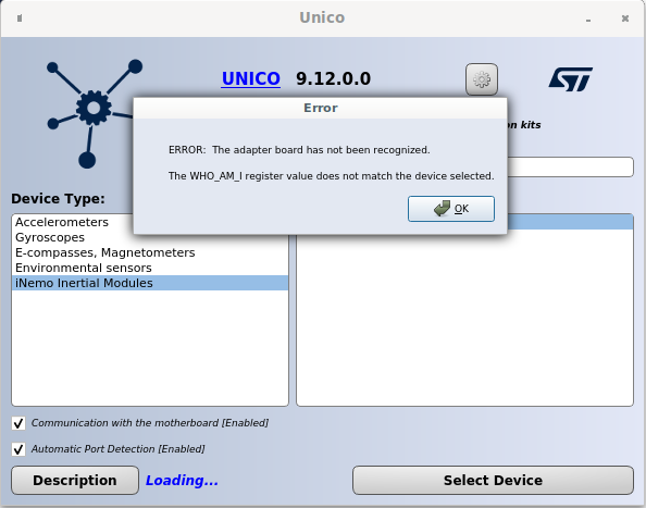

(1) We did it using a freshly downloaded Linux install from ST website. The Linux distribution is Debian Buster on AMD64. We got similar error as show below:
Here is also a picture of the STEVAL-MKI109V3 board where we see some LEDs solid. This could help you?

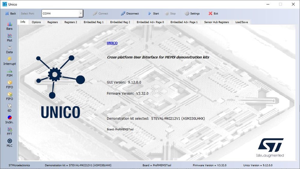

2022-09-29 6:44 AM
-solved issue-
With no change at all on my PC Software Tool Unico, it worked at first start with the boards you sent me.
My issue likely came from the one I bought that was not functional.
