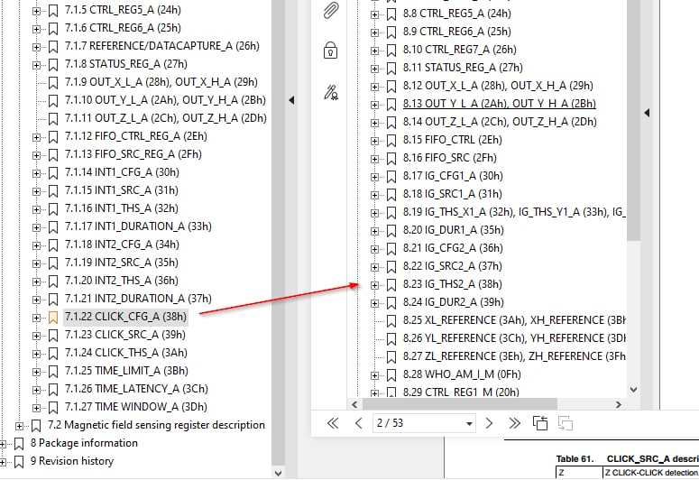

LSM303DLH has CLICK register to setup it but LSM303C has only commont THS and DUR registers set, can I use it to detect single tap event?
As I understand I can setup AND config for all axis, but it doesnt work so good and I can get false detection for some angels of device

}My aproach is right? Is possible to do it on LSM303C ?

Hi @Denis Krasutski ,
First, I suggest you not to use the LSM303C product, since it is obsolete.
You might try to change the duration of, and/or to activate the High-pass filter in the CTRL_REG2_A (21h) register.
