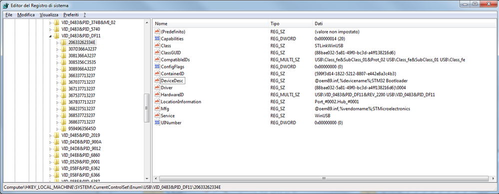

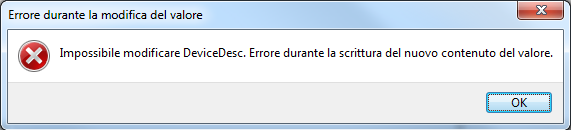

Hi Marian,
I run regedit as administrator, but I didn't find a "Friendly Name" under the (USB VID and PID). It's written as "Device Description" and there is "@oem89.inf,%devicename%;STM32 Bootloader" but i'm not allowed to change it. A message appears that says that I can't modify it, Error Writing the new content (I changed only STM32 Bottoloader in STM32 BOOTLOADER). See the attached file to understand the problem
I use windows 7 with 64 bits.
You told me that it's possibile to reload a new driver (probably more update). Should I disintall STM32 Programmer and download and reinstall a new one? Otherwaise where can I find a update driver?

2021-05-14 3:19 AM
Or do I need to create a new "folser" in the registry with "Frendly name" and write "STM32 BOOTLOADER"?
Thanks,
Cristian
2021-05-14 3:32 AM
Or do I need to create a new "folder" in the registry with "Frendly name" and write "STM32 BOOTLOADER"?
Thanks,
Cristian
2021-05-14 7:02 AM
My first idea was that you have too new driver, but I checked it again and realize that there is no difference between newest driver and my current driver. I guess that driver change will not help. The new information is that you have Windows 7. My proposal was for Windows 10. You can try to create REG_SZ value "FriendlyName" with string "STM32 BOOTLOADER" (there are two spaces between '2' and 'B'). It could maybe help. But you have to put this value into all subkeys inside "VID0483_PID_DF11" registry key, because it is difficult to detect which subkey is related to your device.

2021-05-14 7:46 AM
It seems that regedit doesn't allow me to write in the folder (even if it is run as administrator). Now I've decided to try to update the O.S. to windows 10 to solve the problem. I hope everything can be run the same since I have installed many older programs...
2021-05-14 8:08 AM
It is weird that you cannot write registry as administrator. Try to check again if you really start it as administrator. In Windows 10 you can use BLE communication in addition.

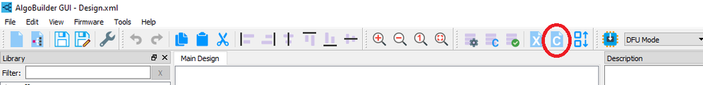

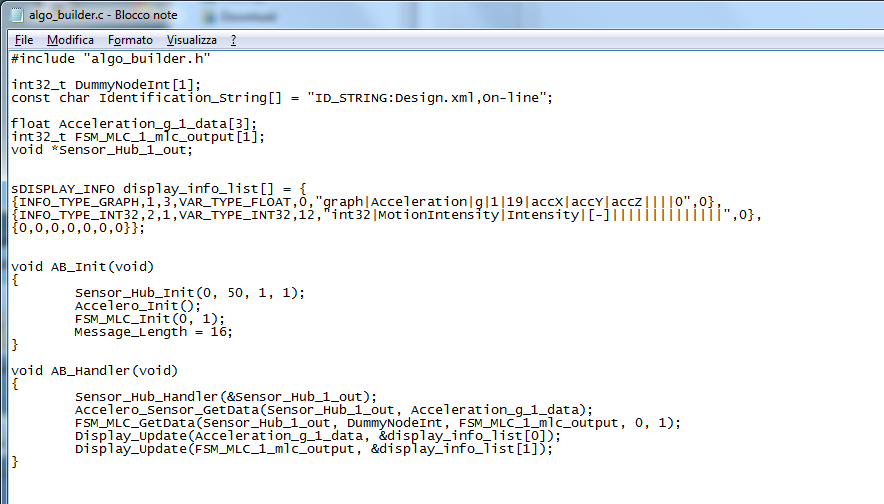

Hi Marian,
Another question. Where can I find the code of the firmware generated that initialize the accelerometer sensor?
When I click on the button below,
This screen opens:
this windows open...
Is this all the code I need in my microprocessor to have the operazion done? (obviously with the driver...)
Where is the code generated?

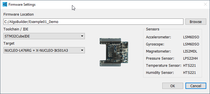

2021-05-21 6:24 AM
Hi Cristian,
algo_builder.c file is the part of source code which changes according to algorithm design.
The rest of source code is placed inside directory specified in "Firmware Location" (see the picture).
Inside sub directory "Projects" are placed configuration files for all supported toolchains.
You can open the project in your preferred development IDE to see whole structure of the project.
