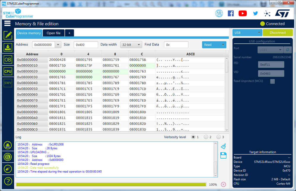

I use Algo Builder to test the sensortile.box, but I can't program the board using the algobuilder software (after I have compiled) in order to test the functionality, even if it seems to be possible to program the microprocessor using directly the STM32CubeProgrammer, and the driver in the device manager seems to be correct.

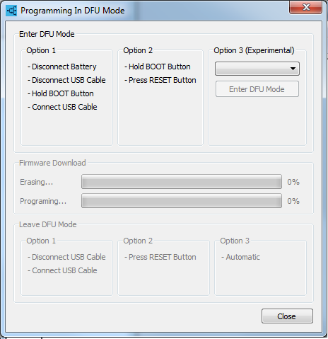

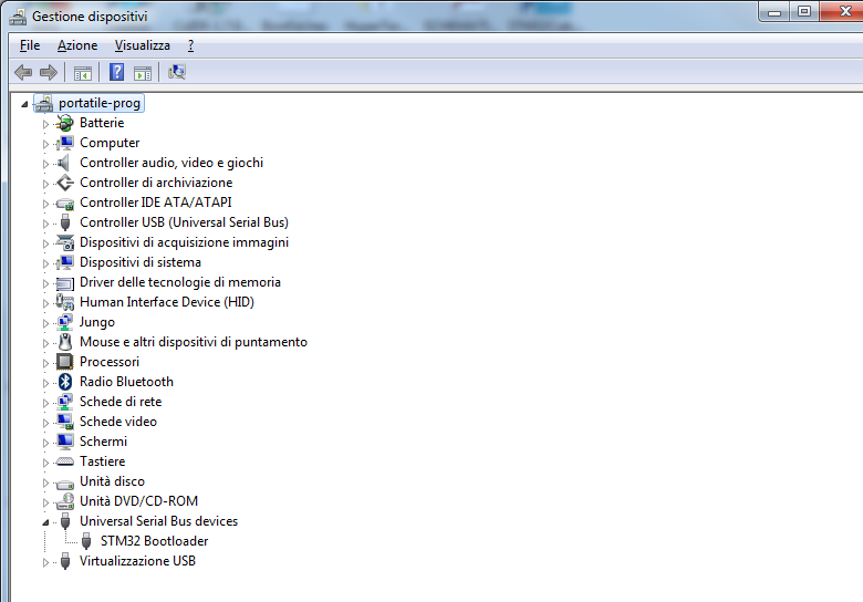

As you can see from the images there is STM32 Bootloader in Device manager and the STM32CubeProgrammer works.
But The DFU windows doesn't start. Under Option3 should appear COMXX (in the webinar I saw this) but is void
I can try to find the file generated file, but is it possible to make it work?

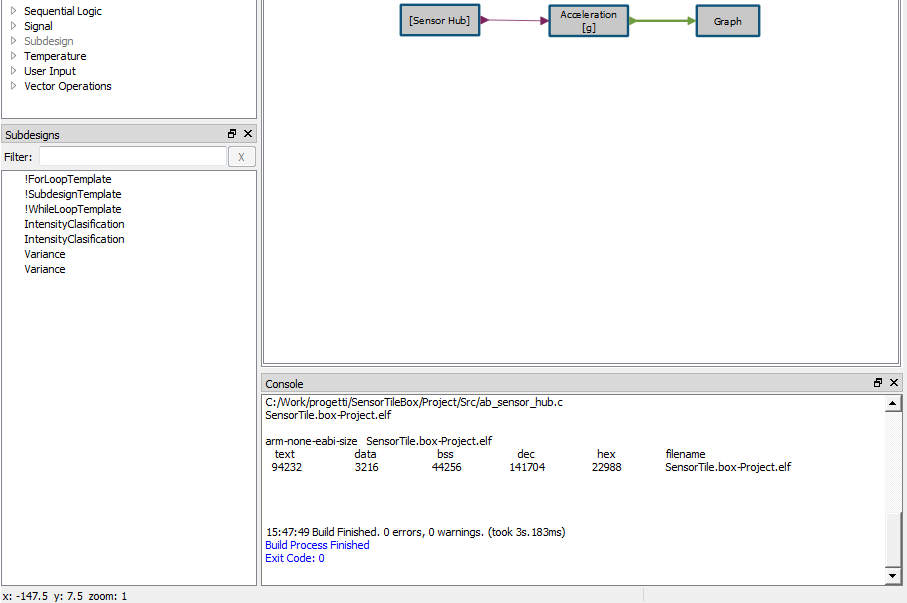

Yes. It compile, but don't program.

the problem is in detection if any device in DFU mode is available. Friendly name of device instance is used for this purpose.
The string "STM32 BOOTLOADER" is expected but "STM32 Bootloader" is received in your case.
This issue will be fixed in next application release.
