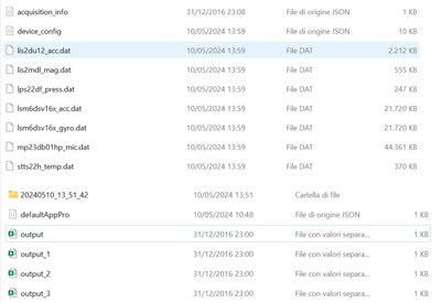

2. My second issue concerns data saving to an SD card, which does not seem to be working. Despite leaving the SensorTile Box running overnight to log data, the newly created output.csv file on the SD card is timestamped "31/12/2016 at 13:00" and is only 1KB in size. When opened in Excel, the file is empty except for the columns labeled by data type. I also tried using the Datalog2 firmware, and although it saves files in a folder labeled with the date and time, each file (supposedly representing a type of data) is an unreadable DAT file. Could you please help me resolve this issue?

Can you detail the flow used: what inputs did you configure and how was the FFT configured? And can you detail the flow used to configure the SD log? What inputs and what function? Still the microphone and the FFT?
About your second question, please follow these steps:
