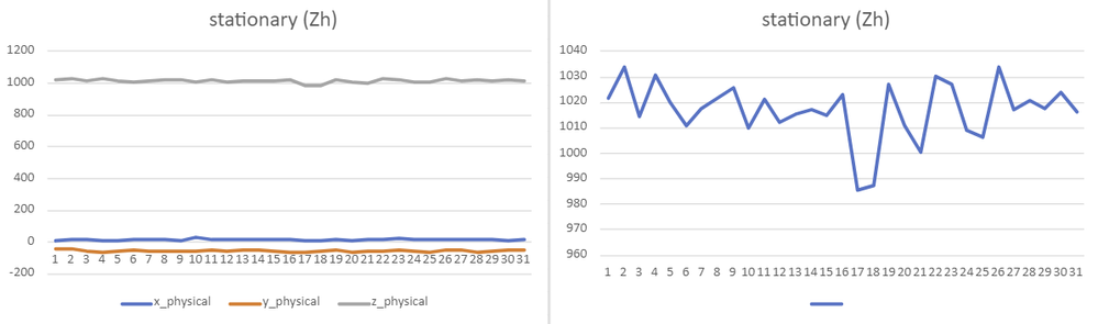

Can you please share the graph when the sensor is in steady state, z axis pointing upward, so that we can check whether there is residual offset?

Hi @Msaga.1​ ,
the stationary data looks good.

I am attaching you the graphs i have made
