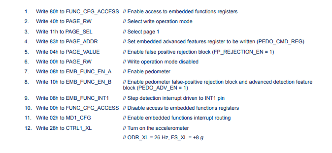

I designed a special board that includes the LSM6DSO32 sensor. I can get gyro and accelometer data from this sensor correctly. But even though I enable the pedometer output in the embedded function part of the datasheet, I can't get it. Can you help me step by step what to do?
I would appreciate if you write step by step which data I will send to which register to make a step counter.

In order to enable the pedometer functions it is necessary to set the P EDO_EN bit of the EMB_FUNC_EN_A embedded functions register to 1. The algorithm internal state can be re-initialized by asserting the STEP_DET_INIT bit of the EMB_FUNC_INIT_A embedded functions register.
A basic SW routine which shows how to enable step counter detection is as follows:
_legacyfs_online_stmicro_images_0693W00000bl6daQAA.pngFor specific details have a look at AN5473 here pag. 54-56.

I know this document. Unfortunately it's completly different than AN5473. It's not a new version. Please take a look and compare them. For example in AN5505 there is not a single word about the pedometer. The documentation page doesn't provide any document helping with pedometer configuration. Actually your comment is the only source of information on ST website on initializing pedometer in LSM6DSO32 :grinning_face: I spent a lot of time looking for information, especially one very important: pedometer needs ODR=26Hz, it doesn't work with any other ODR. Please bring back AN5473.
