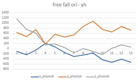

we did tests on the different movements of the accelerometer and the graphs we see (the graphs were made with the x_physical y_physical z_physical values). However we see graphs that are not as we expected;
when we look at a 'free fall' movement we expect to see all axis intersect in value 0, however it is not the case.
For example:

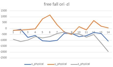

  1. 0693W00000BbSy9QAF.jpgin this image we see free fall when the orientation bit raised on zh (meaning the fall was on zl), but I do not see intersection of all axis ( Z is not even close) and I do not see intersection on 0 - x&y intersect on ~300 . Please explain this.

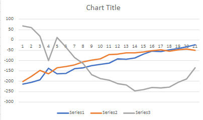

  2. 0693W00000BbT1GQAV.jpghere we do see intersection , however it is around value ~360 and not 0. Please explain why we see it.
More images :

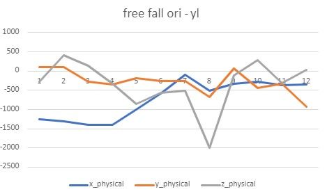

0693W00000BbT2OQAV.jpghere we see that the intersection is ~200

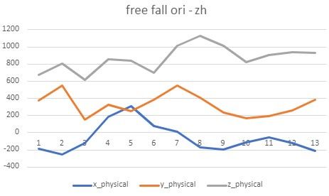

0693W00000BbT2iQAF.jpghere we see that the intersection is ~250 (at 31)

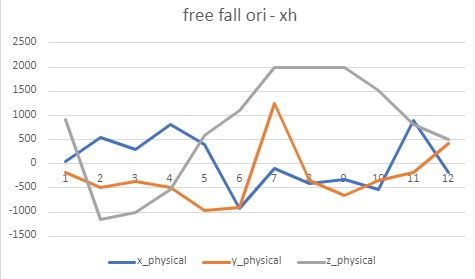

0693W00000BbT2nQAF.jpghere we don't see intersection and the values are not as expected from free fall.
Please help me understand our results.

it could be that the accelerometer has a residual offset, and I'm referring to the plots where you are seeing the intersection among the axes.
I suggest you to first check this residual in a steady condition, i.e. with the device is flat on the ground, with z axis pointing to the sky. In particular, you can tune the X_OFS_USR (3Ch), Y_OFS_USR and (3Dh), Z_OFS_USR (3Eh) registers (see datasheet p. 55) to minimize the offset value.
By the way, is the device in free fall condition during all the plotted acquisition, of just in a small timeframe? Which is the time scale along x axis (if seconds, it's difficult to capture a (fast) free fall in rms value)?
I suggest you in any case alto to check the C example for the free fall app on Github --> lis2dw12_free_fall.c, especially for a double check of the device initialization:

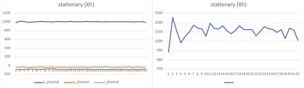

Hi @Eleon BORLINI​ , thank you for your answer,
About checking  this residual in a steady condition I am attaching the graphs for the steady condition:
0693W00000BbdNvQAJ.pngthis is an example on one orientation bit, on all orientation we get the same graph +-g on the appropriate axis. (dont pay any attention to the right graph)
The device in free fall condition during a small timeframe, we want to see the movement graph if we 'drop it'.

By the way, in the stationary graph I see there is a residual offset especially on Y axis, that you can compensate writing the average value in the Y_OFS_USR and (3Dh) register.
The example above shows you how to configure the embedded free fall detection feature in the device, showing you especially how to characterize the free fall event in terms of duration (06h value = 6 * 1/ODR) and threshold (3h = 10LSB), in the FREE_FALL (36h) register.
