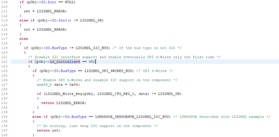

I'm trying to use LIS2MDL magnetometer sensor with 4 wire bus but I'm encountering a problem with the library.

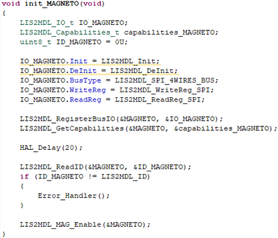

Here is my init function:
lis2mdl.c library screenshot:
On line 122, my instance is always initialized (is_initialized=1) by the init function (line 113) so it always bypass the line 124 to init the SPI 4 wires.
I resolved the problem by replacing the == by != to force the program to init the 4 wires SPI.
Is there a mistake in the library or do I do something wrong ?

* @file lis2mdl.c
* @author MEMS Software Solutions Team
* @brief LIS2MDL driver file
* @attention
* Copyright (c) 2019 STMicroelectronics.
* All rights reserved.
* This software is licensed under terms that can be found in the LICENSE file
* in the root directory of this software component.
* If no LICENSE file comes with this software, it is provided AS-IS.
#include "lis2mdl.h"
/** @addtogroup BSP BSP
/** @addtogroup Component Component
/** @defgroup LIS2MDL LIS2MDL
/** @defgroup LIS2MDL_Exported_Variables LIS2MDL Exported Variables
LIS2MDL_CommonDrv_t LIS2MDL_COMMON_Driver =
LIS2MDL_Init,
LIS2MDL_DeInit,
LIS2MDL_ReadID,
LIS2MDL_GetCapabilities,
LIS2MDL_MAG_Drv_t LIS2MDL_MAG_Driver =
LIS2MDL_MAG_Enable,
LIS2MDL_MAG_Disable,
LIS2MDL_MAG_GetSensitivity,
LIS2MDL_MAG_GetOutputDataRate,
LIS2MDL_MAG_SetOutputDataRate,
LIS2MDL_MAG_GetFullScale,
LIS2MDL_MAG_SetFullScale,
LIS2MDL_MAG_GetAxes,
LIS2MDL_MAG_GetAxesRaw,
/** @defgroup LIS2MDL_Private_Function_Prototypes LIS2MDL Private Function Prototypes
static int32_t ReadMagRegWrap(void *Handle, uint8_t Reg, uint8_t *pData, uint16_t Length);
static int32_t WriteMagRegWrap(void *Handle, uint8_t Reg, uint8_t *pData, uint16_t Length);
static int32_t LSM6DSOX_SENSORHUB_LIS2MDL_ReadShData(LIS2MDL_Object_t *pObj, uint8_t Reg, uint8_t *pData,
uint16_t Length);
static int32_t LSM6DSOX_SENSORHUB_LIS2MDL_WriteShData(LIS2MDL_Object_t *pObj, uint8_t Reg, uint8_t *pData,
uint16_t Length);
/** @defgroup LIS2MDL_Exported_Functions LIS2MDL Exported Functions
* @brief Register Component Bus IO operations
* @PAram pObj the device pObj
* @retval 0 in case of success, an error code otherwise
int32_t LIS2MDL_RegisterBusIO(LIS2MDL_Object_t *pObj, LIS2MDL_IO_t *pIO)
int32_t ret = LIS2MDL_OK;
if (pObj == NULL)
ret = LIS2MDL_ERROR;
else
pObj->IO.Init = pIO->Init;
pObj->IO.DeInit = pIO->DeInit;
pObj->IO.BusType = pIO->BusType;
pObj->IO.Address = pIO->Address;
pObj->IO.WriteReg = pIO->WriteReg;
pObj->IO.ReadReg = pIO->ReadReg;
pObj->IO.GetTick = pIO->GetTick;
pObj->Ctx.read_reg = ReadMagRegWrap;
pObj->Ctx.write_reg = WriteMagRegWrap;
pObj->Ctx.mdelay = pIO->Delay;
pObj->Ctx.handle = pObj;
if (pObj->IO.Init == NULL)
else if (pObj->IO.Init() != LIS2MDL_OK)
else
if (pObj->IO.BusType != LIS2MDL_I2C_BUS) /* If the bus type is not I2C */
/* Disable I2C interface support and enable eventually SPI 4-Wires only the first time */
if (pObj->is_initialized == 0U)
if (pObj->IO.BusType == LIS2MDL_SPI_4WIRES_BUS) /* SPI 4-Wires */
/* Enable SPI 4-Wires and disable I2C support on the component */
uint8_t data = 0x34;
if (LIS2MDL_Write_Reg(pObj, LIS2MDL_CFG_REG_C, data) != LIS2MDL_OK)
return LIS2MDL_ERROR;
else if (pObj->IO.BusType == LSM6DSOX_SENSORHUB_LIS2MDL_I2C_BUS) /* LSM6DSOX SensorHub with LIS2MDL example */
/* Do nothing, just keep I2C support on the component */
return ret;
else
/* Disable I2C interface on the component */
if (lis2mdl_i2c_interface_set(&(pObj->Ctx), LIS2MDL_I2C_DISABLE) != LIS2MDL_OK)
return ret;
* @brief Initialize the LIS2MDL sensor
int32_t LIS2MDL_Init(LIS2MDL_Object_t *pObj)
lis2mdl_cfg_reg_a_t reg_a;
lis2mdl_cfg_reg_c_t reg_c;
/* Read configuration from CFG_REG_C & CFG_REG_A regs */
if (LSM6DSOX_SENSORHUB_LIS2MDL_ReadShData(pObj, LIS2MDL_CFG_REG_C, (uint8_t *)®_c, 1) != LIS2MDL_OK)
if (LSM6DSOX_SENSORHUB_LIS2MDL_ReadShData(pObj, LIS2MDL_CFG_REG_A, (uint8_t *)®_a, 1) != LIS2MDL_OK)
/* Enable BDU */
reg_c.bdu = PROPERTY_ENABLE;
/* Self Test disabled. */
reg_c.self_test = PROPERTY_DISABLE;
/* Operating mode selection - power down */
reg_a.md = LIS2MDL_POWER_DOWN;
/* Output data rate selection */
reg_a.odr = LIS2MDL_ODR_100Hz;
/* Write configuration to CFG_REG_C & CFG_REG_A regs */
if (LSM6DSOX_SENSORHUB_LIS2MDL_WriteShData(pObj, LIS2MDL_CFG_REG_C, (uint8_t *)®_c, 1) != LIS2MDL_OK)
if (LSM6DSOX_SENSORHUB_LIS2MDL_WriteShData(pObj, LIS2MDL_CFG_REG_A, (uint8_t *)®_a, 1) != LIS2MDL_OK)
else
/* Enable BDU */
if (lis2mdl_block_data_update_set(&(pObj->Ctx), PROPERTY_ENABLE) != LIS2MDL_OK)
if (lis2mdl_operating_mode_set(&(pObj->Ctx), LIS2MDL_POWER_DOWN) != LIS2MDL_OK)
if (lis2mdl_data_rate_set(&(pObj->Ctx), LIS2MDL_ODR_100Hz) != LIS2MDL_OK)
if (lis2mdl_self_test_set(&(pObj->Ctx), PROPERTY_DISABLE) != LIS2MDL_OK)
pObj->is_initialized = 1;
return LIS2MDL_OK;

void init_MAGNETO(void)
LIS2MDL_IO_t IO_MAGNETO;
LIS2MDL_Capabilities_t capabilities_MAGNETO;
uint8_t ID_MAGNETO = 0U;
IO_MAGNETO.Init = LIS2MDL_Init;
IO_MAGNETO.DeInit = LIS2MDL_DeInit;
IO_MAGNETO.BusType = LIS2MDL_SPI_4WIRES_BUS;
IO_MAGNETO.WriteReg = LIS2MDL_WriteReg_SPI;
IO_MAGNETO.ReadReg = LIS2MDL_ReadReg_SPI;
LIS2MDL_RegisterBusIO(&MAGNETO, &IO_MAGNETO);
LIS2MDL_GetCapabilities(&MAGNETO, &capabilities_MAGNETO);
HAL_Delay(20);
LIS2MDL_ReadID(&MAGNETO, &ID_MAGNETO);
if (ID_MAGNETO != LIS2MDL_ID)
Error_Handler();
LIS2MDL_MAG_Enable(&MAGNETO);
