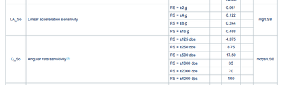

Hi, I am using MKI239A and MKI109V3 with LSM6DSV (IMU).
Knowing the full scale of accelerometer and gyroscope, I still need resolution information to calculate the exact readings. I did not find relevant resolution info on data sheet...
Could you please provide some information? thanks for your help! @Federica Bossi

Hi @ZSong ,
Do you mean how to get dps and mg from LSB? You should look at the sensitivity reported in the datasheet:
