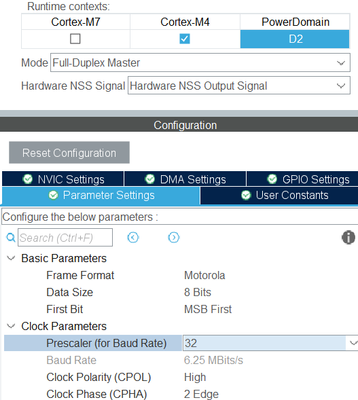

The SPI communication is setup as follows:
With the read and write fucntions set like this:

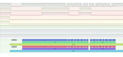

}When I observe the MISO and MOSI with a logic analyzer, I can see that good register value is sent, but I have random 0s and 1s as a return of MISO. Here is a picture of how it looks:

2024-07-22 6:17 AM
The MOSI line first byte is 0b10101110 which is a read of register 0x2E. That's not the WHO_AM_I register. The WHO_AM_I register is at 0x0F.
You should also uncomment the CS line commands. Not using them can get you out of sync with the chip.

Here is a better screenshot of the logic anlyzer when a query for the WHO_AM_I register is sent:
In this configuration, MISO is not reading the value of the WHO_AM_I register. Am I supposed to send another address through MOSI to get the correct return information?
