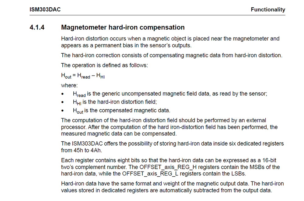

Hello Everyone!!!
I am using ISM303DAC in my project E-Compass, I am facing an issue regarding hard iron calibration. in datasheet it is mentioned that we have do hard iron calibration using external processor  and has to store those values in the internal registers of sensor.  here i don't know how to do the hard iron compensation can anyone please let me know the procedure/steps to do the hard iron calibration if any example is available with you please provide me.

Hi @Anil3 ,
You can use MotionMC library to implement the hard iron compensation.
Here you can find the user manual, let me know if you have any other doubt.
