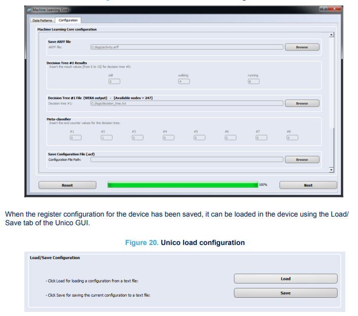

2019-04-04 7:15 AM
Hi, I suggest you this procedure: when the register configuration for the device has been saved, it can be loaded in the device using the Load/ Save tab of the Unico GUI.
You can save the configuration file, to have the dump of the memory regs. These values can be inserted in an example file of X-CUBE-MEMS1 the LSM6DSO acquisition (same as LSM6DSOX as regard the data acquisition)
Regards
