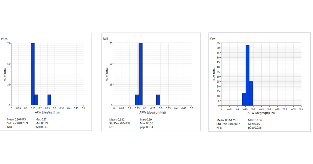

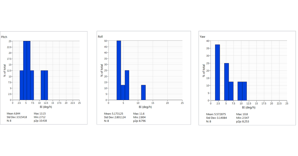

The random walk and bias stability of the LSM6DSM gyroscope could not
be found in the data sheet.
Random walk , bias stability of gyroscope Please tell me the reference value.​
1 ACCEPTED SOLUTION
Accepted Solutions
Eleon BORLINI
Hi @totaw.1​ ,
AVAR parameter are not fully tested in the inline tester production, that's why they are not in the datasheet with upper and lower spec limits.
I can however share bench results on a representative sample, tested in the following conditions:
VDD = 1.8V
VDDIO = 1.8V
ODR XL = 208Hz HP
ODR Gyro = 208Hz HP
Synchronous reading
Temperature Range -40 ÷ 85DegC
Angular random walk of gyroscope:
0693W000007ZjWoQAK.pngBias stability of gyroscope:
0693W000007ZjWyQAK.pngIf my reply answered your question, please click on Select as Best at the bottom of this post. This will help other users with the same issue to find the answer faster.
-Eleon

Eleon BORLINI
Hi @totaw.1​ ,
VDD = 1.8V
VDDIO = 1.8V
ODR XL = 208Hz HP
ODR Gyro = 208Hz HP
Synchronous reading
-Eleon

Is there any data on the acceleration bias Repeatability  and scale factor Repeatability  ( / year ) of LSM6DSM?
Eleon BORLINI
Hi @totaw.1​ ,
thank you first for your appreciation.
About the "acceleration bias repeatability" parameter you might consider the standard deviations shown in the above picture: they accounts for a confidence interval of
About the "scale factor repeatability" over year, which I interpret as the change / drift in sensitivity across 1 year, you can consider the ±1% sensitivity tolerance that you can find in the datasheet, p.23.
-Eleon
Is there a unit problem of Angular random walk of gyroscope in your answer ?
I expected the data in "deg/s /sqrt(Hz))" or in deg/sqrt(h) ?
