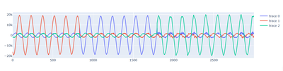

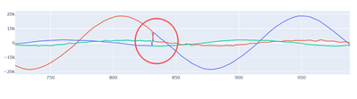

I am developing a vibration measurement device using LSM6DS3TR-C. Most of the time the data were in good shape (99%).  However, I noticed some spike in my vibration intensity reading randomly. After checking the raw data I saw some step change at the same time point, indicating the data reading of the three axis are confounding.

I have collected all information from internet about the misalignment buffer issue and tested out every method suggested by ST members (using ST library, BDU=1, IF_INC=1, watermark, continuous mode / fifo mode, etc.). And I am still stuck with this bug.
When using 3332Hz and FIFO I could never get a clean multi-FIFO reading that does not misalign. Checking the fifo pattern wont work as this shift happend in the middle of batch reading, not at the start. If I need to check every pattern when reading out the FIFO, the I2C won't keep up. Even if the IO was fast enough, what should we do to deal with the missing/disordered sample? Do we have to drop the whole data and resample a new piece?

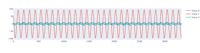

For those who reached here after searching. I have my final conclusion: the LSM6 is NOT suitable for using FIFO to acquire multiple FIFO data due to racing condition of concurrent FIFO writting from sensor and FIFO reading from the controller. The ONLY approach that gave me steady clean waveform below is to use spinlock (busy wait) + reading the output registers (28h). It seems 3332Hz ODR is already too much for polling STATUS_REG for new data and one has to control the read-out timing by utilizing the delay timing. I would say it is a huge bummer for this product. After all it failed what the FIFO was designed for: NO BUSY WAITING!
