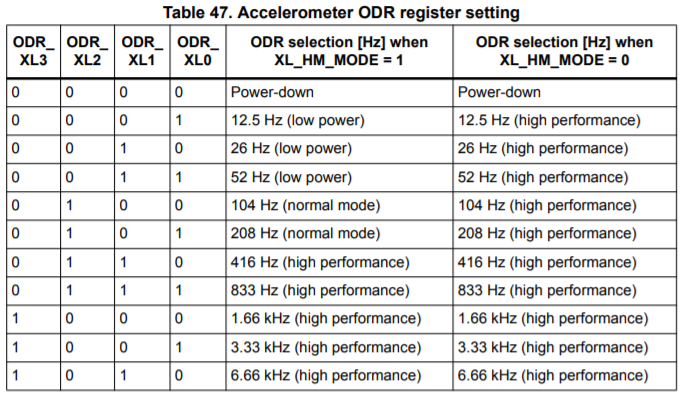

it should be possible -at least theoretically-, but I'm not an expert of these drivers.
Please refer to the Linux drivers on Github, for the specific product LSM6DS3 (st_lsm6ds3).
Here the limit is 416Hz too:
#define ST_LSM6DS3_ODR_416HZ_VAL 0x06Probably it is enough to add a define with the values according to the codification you can find on the datasheet p.54.

with the current linux driver structure, it doesn't make sense to extend the support for ODR > 416Hz, since it wouldn't be guaranteed the handler execution. Something can be implemented if and only if the sensor is used in batching mode (decimation bits in FIFO_CTRL3 (08h) register, see datasheet p.48), in order to match the max ODR-416Hz condition, using the FIFO with high watermark values.
Let me please know if it can be feasible for you.
