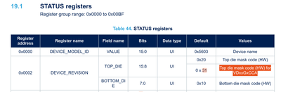

I see what you mean.  So all the camera's in production now are VDxxGxCCA camera's.  Which is great news thanks for clearing this up for me.
You can tell it's a VDxxGxCCA because of device_revision

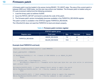

They don't need the firmware patch 

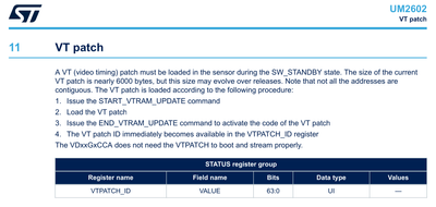

Or the software patch
