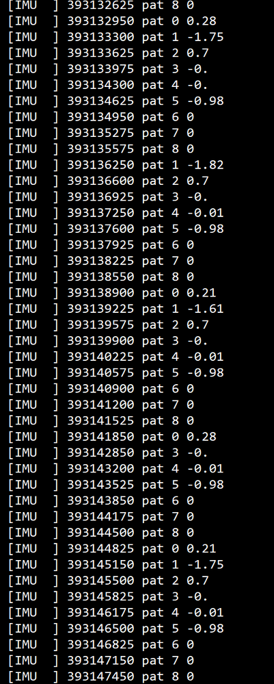

These are the results:
Gyro and accelerometer data are well converted, but I always read 0 to pattern 6-7-8, even if I can read timestamp registers correctly.
results: Timestamp in polling + #pattern + converted gy/axl and zero timestampresults: Timestamp in polling + #pattern + converted gy/axl and zero timestamp

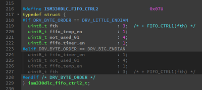

but since you highlighted the fact that is the 7th bit I guess I have an answer:
Take a look at ism330dlc_reg.h:
this struct splits register in 9bit instead of 8, so I don't know where I'm actually writing
agreed - in the official driver there is a bug: not_used_01:3 is the correct code for the bitfield definition of FIFO_CTRL2
will amend ASAP - let us know if this fixes your issue

I opened this pull request
https://github.com/STMicroelectronics/stm32-ism330dlc/pull/2
The problem was there so this fixed the issue
glad we found the issue!
