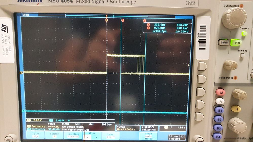

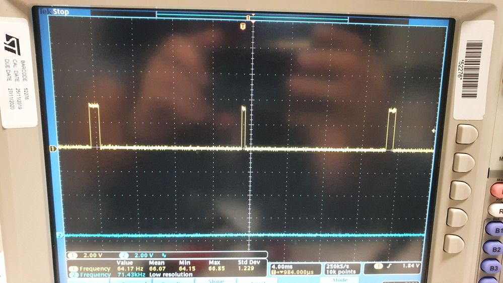

Hi @Loris Wyss , what I can see following this procedure is that I can see the interrupt on INT1 (instead of on INT2 as you reported.. I tried to trigger the shot on the INT2 signal but it is always at 0V, see the blue line), and this interrupt is flickering in DURATION of about the quantity you reported. This could cause the jitter. But the distance between the rising edge of two consecutive interrupt pulses seems the same (cursor measure of 15.60ms)...
Single shot screen:
Multiple shots screen:

2020-06-30 2:49 AM
Hi @Eleon BORLINI
Thanks for your feedback, You're right I mixed up the interrupt pins in my instruction-post.
It's strange that you don't see the Jitter on the rising edges. I just tried it again and I can still see the exact same behaviour as described/shown in the first post.
Could you try zooming in at the rising edge, which follows the one you triggered on? If you let the measurement run, you should be able to see that the rising edge is jumping between two positions...
