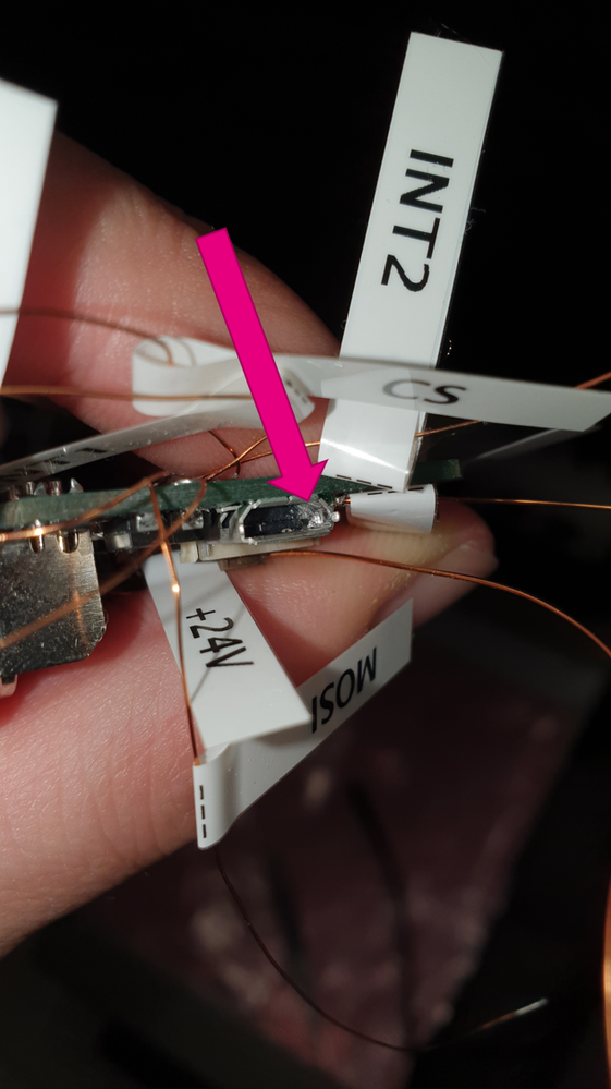

Hello @Loris Wyss , you are fully right and I'm here in lab to try to test the board, but the USB connector seems damaged (maybe due to the soldering of the GND wire), so I cannot plug the USB easily.
Since in these days I'm pretty alone in lab, what I can suggest you is to ask for support to the ST regional sales offices/representatives and FAE. I may send them your PCB, if you open your OLS request. Regards

Well, the USB-Port isn't needed to put the Board in operation, it's only for Logging/Debug Purposes.
The PCB is powered through the GND/+24V-Pins.
