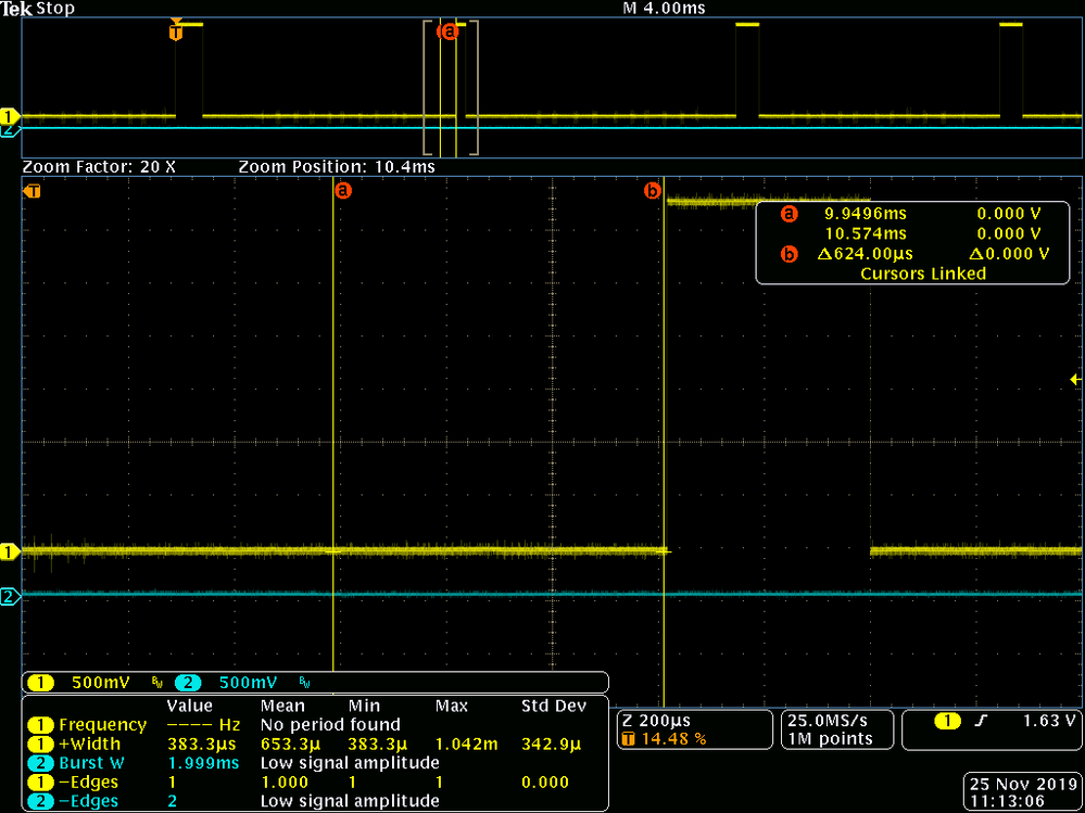

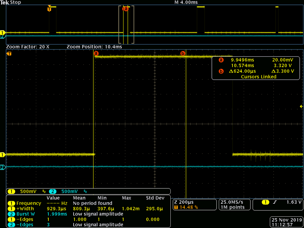

When I'm using the LIS2DW12 at ODR=1.6kHz, the Interrupt for reaching the FIFO-Threshold is jittering with 1/ODR, but only if the threshold is greater than 12. If it's less or equal, everything is working fine.
The buffer-Mode is set to FIFO-Mode, but this behaviour also occurs in Continous-Mode.
The Power-Mode is set to High-Performance/Low-Noise.
The Interrupt is routed to the INT1-Pin
The two images show the rising edge on the pin INT1. The time between the two cursors "a" and "b" is 624us (almost 625us), which would equal to 1/ODR (1/1600 = 625E-6)
As written, this only happens if ODR is set to 1.6kHz and the FIFO-Threshold is greater than 12.

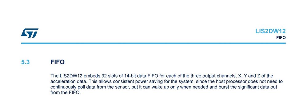

From the informations provided by the datasheet I thought, the FIFO would contain only the acceleration data.
Additionly I assumed, that a FIFO-threshold of 12 meant that there is an Interrupt when I have 12 Samples (each consisting of 3 Axis * 2 Bytes/Axis) in the FIFO, which would result in a total of 72 bytes of data.

I'm sorry, the gyro part doesn't make sense :) I was confused from a parallel thread on iNemo FIFO.
Basically you well interpreted the documents, the threshold refers to the complete filling of the 6x12 bytes.

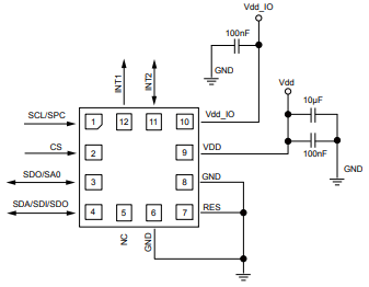

I made a sample project, where I removed everything unnecessary, so you can check the software implementation.
I also included the relevant part of the schematics.
If it would help you, I could also send you a PCB, with which we had this issue, so you can measure and try yourself (I assume you live in Europe, right?)
Just let me know, if this would be a possibility.
Regards,
Loris
2019-12-16 6:58 AM
Hi Loris, it would be of great help if you could send us your PCB, if it is not of too much effort for you. Can you however share your application .bin file? I don't use MDK-IAR... Regarding your schematic, and the decoupling capacitors in particular, they are not as the suggested ones... This should not be an issue, but let's take it into account

2019-12-16 7:15 AM
Hi Eleon
Thanks for your answer. i attached the .bin file to this answer.
Regarding the Capacitors:
I've seen this as well while checking and we will probably change with the next redesign, but I also assumed, that this isn't the problem.
