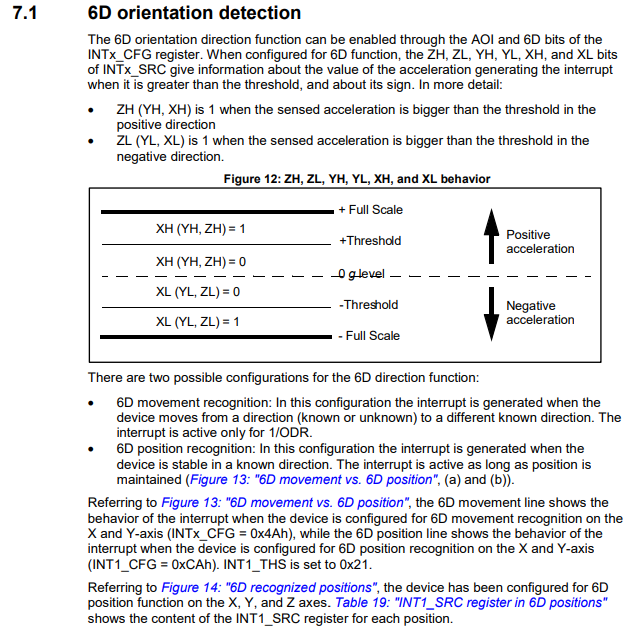

I am trying to implement 6D mode. I am following 1:1 the code documented in the design tip DT0097.
I have been trying for a while: I2C interface is working and other modes of LIS2DH work properly.
As a safety measure, during the init I reset all registers back to their default value.
I read IRQ_SRC as soon as the INT1 line is raised.
However, the behavior is not as expected:
I do get interrupts when I move the board, but:
In the interrupt, I simply read INT1_SRC, that should be enough, right?
This is an example of events I get while flipping the Z axis of the board. Val is the (hex) value of INT1_SRC, while the rest is the string is my decoding of it.
Do you have any hint or fully-fledged example?
val:66 XU YD ZU
val:15 XD YD ZD
val:65 XD YD ZU
val:15 XD YD ZD
val:66 XU YD ZU
val:15 XD YD ZD
val:56 XU YD ZD
val:15 XD YD ZD
val:69 XD YU ZU
val:15 XD YD ZD
val:59 XD YU ZD
val:15 XD YD ZD

I tried to achieve the same result doing a simple inertial wake up on axis z, as per the application note you posted. So, I expect an interrupt when axis Z value is above a certain value (so the board is laying on one of the two faces).
The results are the same: I get 2 IRQs every time, and the INT1_SRC doesn't show the real condition. It's almost like hp filter is active, because I always end up with lower poart of INT1_SRC = 0x15 (all the "low" IRQs).

Hi @vcaia.1 , thank you for the detailed analysis. Can you try with modifying the interrupt duration? You can do it either latching the interrupt, i.e. setting to '1' the LIR_INT1 of the CTRL_REG5 (24h) register or directly changing the duration of the interrupt itself, by modifying the register content in the INT1_DURATION (33h) register. Regards
2020-03-26 6:01 AM
I tried that, but I tried again now based on my code posted above.
LIR_INT1 has no effect, I see no difference.
Duration is already 0x20. (that should be 1280ms @25hz). Even if I put that one to 0x7f (5s!)I see no increased delay between events.
I understand the duration register as the time the event has to last in order to trigger the interrupt (e.g. the Z axis must be > the threshold for 5s) is it correct?
Or is it just the duration of the pulse on INT1 and it's enough to have one sample over the threshold?
2020-03-26 6:09 AM
So one problem looks to be that ISR routine was called both on rising and falling edge. This has been solved now, but I still get some unwanted results, when moving the board really slow.
