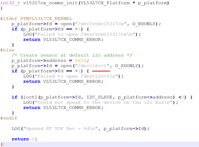

You can try to debug with user space first; make sure you are using the correct I2C bus number in the code according to you HW connection.
you can use i2cdetect -r -y 1 command to check if the device is well detected.
Br
Zhiyan.Han
2025-10-30 4:24 AM - edited 2025-10-30 4:24 AM
Did that already. It's still failing. Device is visible on i2c bus using i2c-tools.
I manage to load kernel driver and to compile userspace part of driver by enabling kernel support via Makefile.

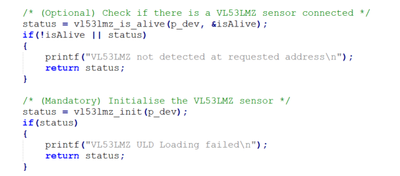

Then I tried to run test program 12, it fails with: "VL53LMZ ULD Loading failed".
Without kernel driver by using just everything in userspace it also fails with similar message.

Your basic I2C read function should works as long as there is no error from vl53lmz_is_alive().
you can check you I2C signal or debug low level of I2C write, as inside vl53lmz_init(), there is 86K bye FW writing as John mentioned, so the error could come from I2C big data writing.
