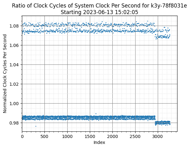

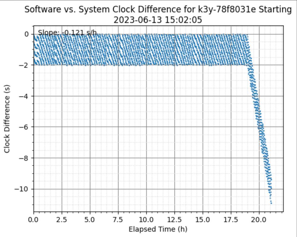

Following plots are from the experiment we ran with High-accuracy ODR mode with only accel at the beginning, and as you can see there is no drift during this period.
We activated the gyro and you can see a visible constant drift comes right after the activation of gyro.
These plots are FIFO timestamp vs system clock.
The first plot is for the IIO_CHAN_SOFT_TIMESTAMP (hw->tsample).
The second plot for the same experiment is for the IIO_CHAN_HW_TIMESTAMP (hw->hw_timestamp_global).
Currently, we are getting the following drifts with the activated sensors:
 - Accel-only: zero drift
 - Gyro-only: a constant negative drift
 - Both Accel and Gyro activated: a negative drift bigger than the last case in absolute terms.
