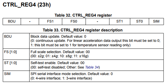

Uh I didn't get you. Where do I get the selected FS bits from?
Sorry I'm a complete newbie2018-06-19 3:13 AM
In CTRL_REG4 register.
